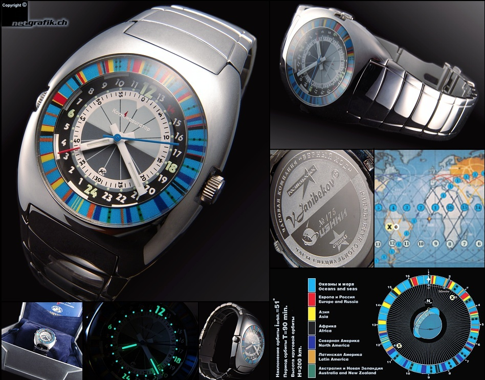

Her er en collage av den første versjonen av denne klokka med litt grafikk som viser tanken bak det hele.

Klippet fra et intervju med kosmonauten som kom på ideen:
"If you look at the projection of the trajectory of a spacecraft flying above the Earth, it looks like a sinusoid, and each subsequent revolution is offset from the previous one. The period of revolution of the spacecraft, that is, the time during which it makes a revolution around our planet, is approximately 90 minutes. Based on these data and knowing the initial time, it is possible to calculate over what part of the Earth at what moment in time the spacecraft is located. The idea of this watch is that, looking at the dial, you could immediately determine where the spaceship is now. To do this, I came up with a special bezel, the sectors of which are painted in different colors representing the continents: Europe and Russia - red, Asia - yellow, Africa - black, Australia and New Zealand - green, North America - blue, South - orange, and oceans and the seas are naturally blue.
GZR: But does the circulation period depend on the flight altitude?
Of course, the Cosmonavigator also has a certain error for this reason. We give the crews of spaceships such a watch before flying, but this is more of a souvenir, which the cosmonauts then, for example, give to their friends. Nevertheless, their families can very well follow these hours where they are flying now, and even in the Mission Control Center, staff can use the clock, so to speak, as a first approximation. There are thoughts to create a more accurate device that could be adjusted depending on the period of treatment, and it would work very accurately. But this is not an easy task for watchmakers, it turns out to be a complex and expensive mechanism, and such things should be done already for a specific customer who will pay for all this."
