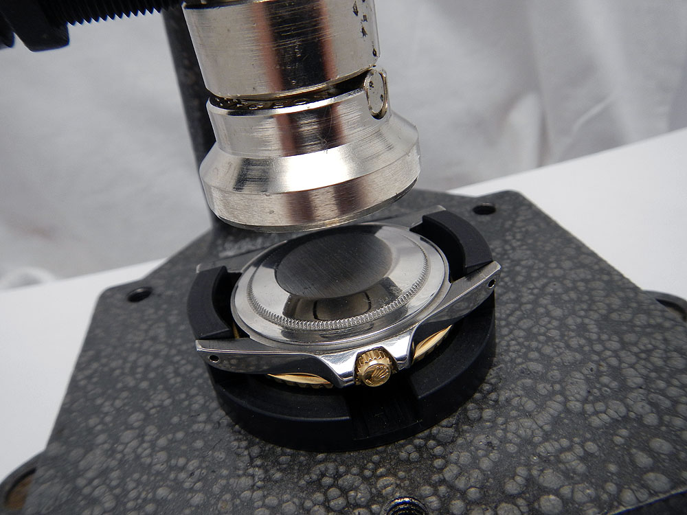

Up with the case in the bezel remover.
There goes that one.

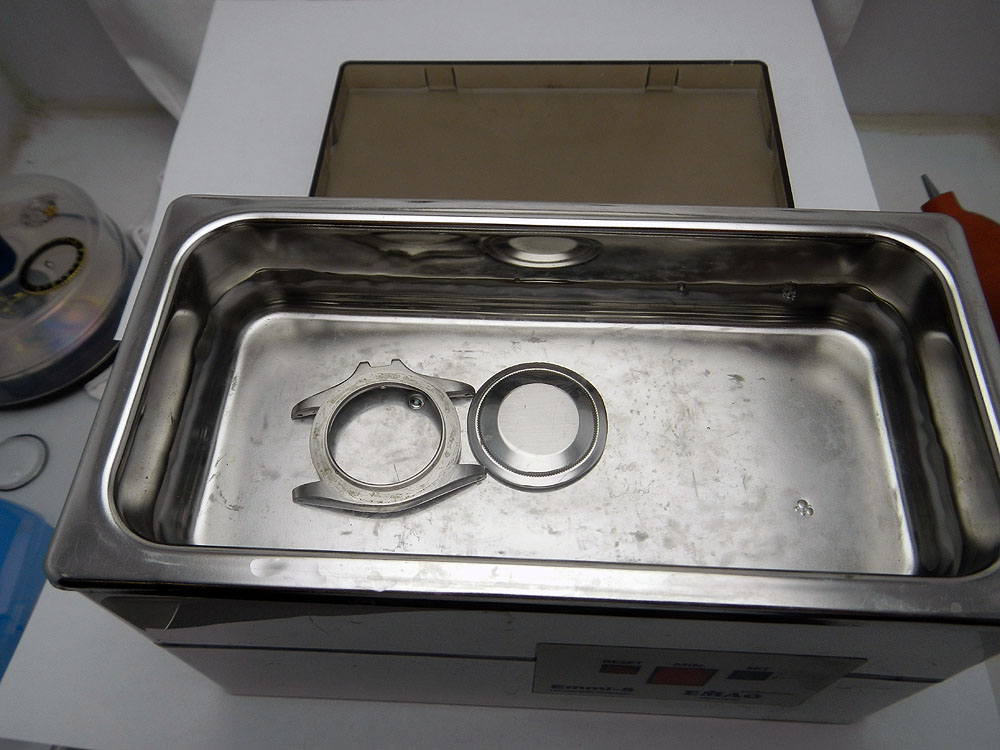

The crystal was glued, not a good idea. So next step is to pull off the crown tube.
And a bath.
Then I remove the rest of the glue and brush the surface.
I believe that will be okey now.

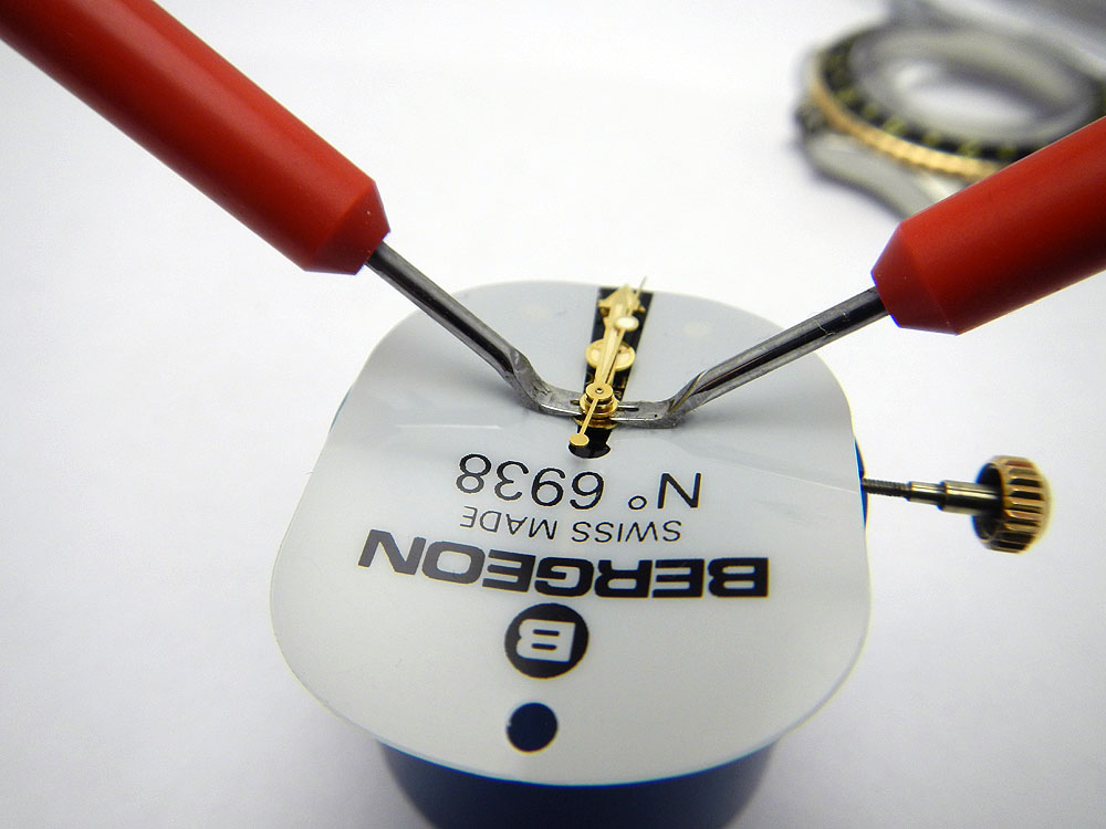

And of course a fresh set of hands with the orange hand.
So now it's time to put the hands in place.
The orange fits like a glove.
And the rest.
